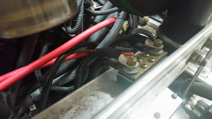

So the ground wire connects each battery to the ground bar, then I ran 2 additional wires from ground bar and connected to original location of battery wires. As far as i can tell the battery switch is wired correctly. Boat operates fine it just gives the listed above symptoms.

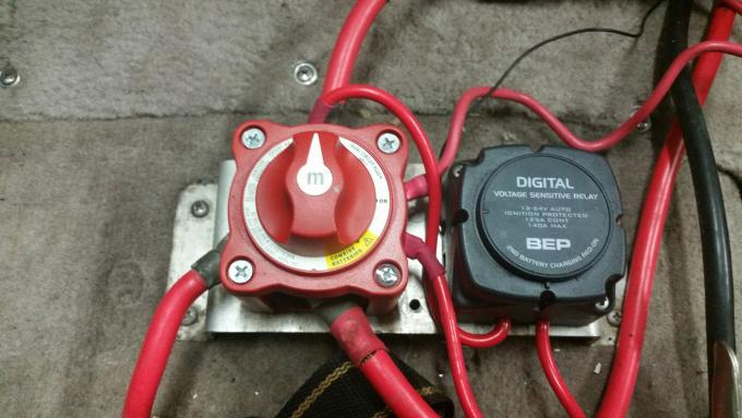

I have the wired the like this:

This is the VSRrelay used:

I've been looking at more diagrams online, and it looks like the one I used (pictured above) is wrong. The VSR should be connected to the live posts and not the load. Could this be my problem. I can't try it today, but my brain hurts from thinking about this.

I see no issue with the VSR on the boat side of the switch. its actually the ideal method when a charger is part of the scheme. A volt meter on the VSR would tell you a lot, without removing it. Also, remove the control ground and see if the mystery light goes out. In addition to whats already posted here, Id look for a voltage drop on those ground cables.
