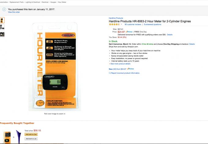

I recently added this engine hour meter on Amazon since the original tach was non-functional and I sold the original perfect pass, which logged the hours, to replace it with my newer hydrophase unit.

The hour meter is self-powered and attaches to one of the spark plug wires. I installed it about 10 minutes.
