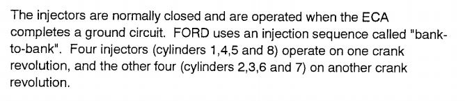

        From what I understand on most Ford trucks in the early 90's with the 302 and 351''s they were EFI not Sequential EFI. On a lot of the trucks they used Mass air flow sensors to calculate fuel rate. The boat is set up for speed density the same as a 86 GT Mustang. The throttle position sensor tells the computer how far open the throttle plate is and delivers the correct amount of fuel. I think the EFI in trucks and vans fires two injectors at one time. The one in the 86 Mustang was SEFI and it only had 19 lb injectors. The 351 in the 93 Cobra with the 351 has the 24 lb injectors and is SEFI but it is set up for Mass air flow. Maybe it is just a program change, but could be a hardware change. Hope this helps.

            This is off on a tangent perhaps but to touch on what your saying for my own understanding the GT40s EEC is set up to run based on speed density because there is obviously no MAF sensor which is what your saying I think and also does not run SEFI as there is only 4 (fuel injector) wires on the EEC side of the 60pin connector so each of the 4 wires must be running 2 of the 8 injectors during any given pulse signal sent by the EEC? So the GT40 EEC is based off speed density and EFI not SEFI? Im wanting to confirm this becasue another option that might be for tinker type would be a full blown after market EEC and tuning it from scratch. Megasquirt makes a ford EEC-IV 60 pin EEC that with some self education and desire could be set up to run on the stock GT40 engine harness and tuned to run these GT40s. Much more work than chip burning but my buddy has a megasquirt he tuned from scratch to run a highly modified turbo BMW engine he built from parts and the megasquirt is really cool because it allows for data logging which besides being cool provides for easy trouble shooting in the event of many engine issues. Just hook up your laptop and see what went wrong and when...

              Yes, in reading on the Ford eec tuning forum, I remember the GT40 uses batch pulsed injectors rather than sequential, so either two at a time or 8 at a time are fired. It is for that reason we are targeting a 4-cylinder computer rather than all 8 being individually controlled. If we go to Megasquirt, I believe it could be advantageous to switch to sequential injection, but then a new harness would be necessary to provide individual connectors to each injector.

                    I could be wrong but I think the GT40 fires 1 bank (4 injectors) at a time. It's in the service manual some where as I recall reading about it in detail.

                      Here is the part from the manual describing the injector sequence. Not quite like I remembered.
