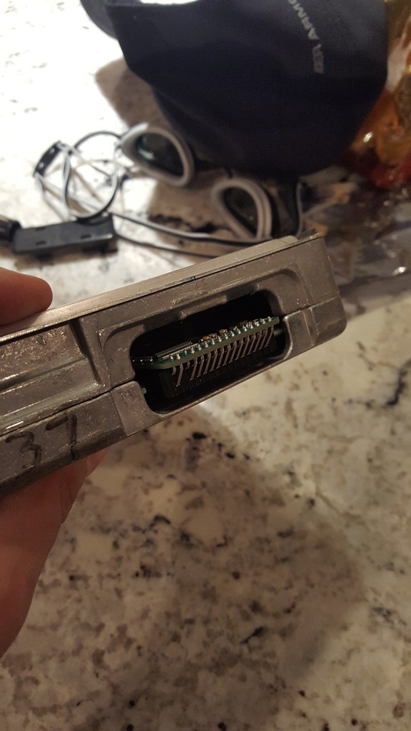

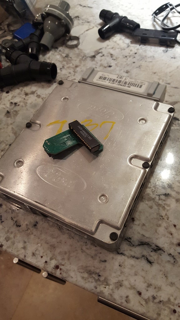

            Awesome... where does the chip plug in at? I couldn't tell from the video. Can you post a pic of the ecm with the chip.

              #21
              as requested.... you just remove the cover off the rear of the computer and plug it in. i did have to push one of the capacitors down a little on the mustang computer

                  So PCM obviously just sourced the ford ECMs and programmed them with their own tune. Makes me wonder if this can be done without the use of the chip? Probably just a matter of having the hardware or software to do it without the chip... so the moates that you guys are talking about is what is being used to read the factory PCM tune and then write that tune to the chip? The chip is a moates product?

                      For anyone that wants a backup ecm, first thing would do is buy either a C1A1 or D1L1 ecm off eBay, etc. Then download a copy of the file I posted. You are in pretty good shape after that. The moates stuff is pretty common and it wouldn't be that hard to find someone to program a chip for you as long as you have a copy of the file I posted. The moates chips seem to be readily available as well.

                            I used the burn2 option to read my marine ecm and then burn to the f3 chip. If you only wanted to burn the file I posted to a chip you could just buy the jayhawk. With that said, I copied it off a 97, I'm pretty sure there was a newer version of the ecm tune released in 98-99. Although I have had zero issues with the 97. But what I was getting at is, it would be nice to make a copy of the ecm on a newer version as well.
