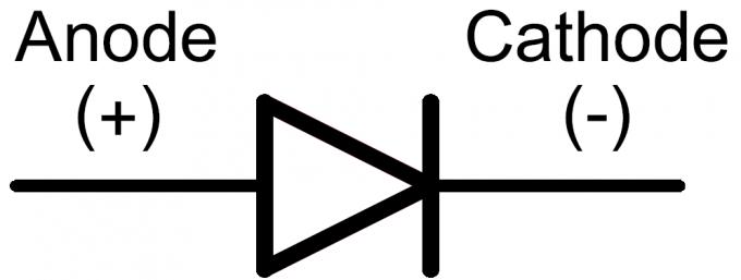

                    If you have a set of alligator clips, or spare wire you can jump the diode out to see if that is the case. The wiring harness will be a bunch of wires wrapped together. Follow the wires from the solenoid and they should all come together into a black plastic tube usually taped up with electrical tape. Use a razor blade and open up some bare wire on either side of the diode to jump it out to see if that is in fact what is wrong. The diode will most likely be a black tube with the symbol on it in the picture I attached. Click image for larger version

                      #25
                      Awesome! Thank you very much. I'll check it.

                            2000superdare, I did get most of the ignition (yellow) wire cut open but I couldn't find the diode. The yellow wire ran straight from the starter to the relay (which is where I was getting the clicking).
