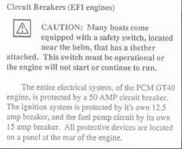

    Which engine is in the boat? Did you check the 12.5 amp ignition beaker?

      It is the Ford 5.8L engine
      I'm not familiar with the breaker normal operation as have never checked them before. But the 12.5 and 15amp breakers have a little play in them when i push them. the 50amp or actually says 60amp on this engine is frozen solid (no movement at all). So something seems wrong with the 60amp, but was hoping someone may know if this is different then a normally operating 60 amp breaker.
      Thanks for responding and great work on this forum, I browsed through a lot of post and seems like could be something as simple as this breaker or blowing out the entire ignition panel.

            if the breaker has no play in it, its typically seized. you should be able to rock the bottom up and down on a good breaker. i had a 50 amp go out on a boat i sold last year. nautique parts has them
