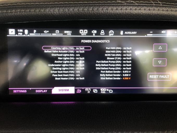

ID:	584205 I took a pic. look at voltage. There was a g23 nearby and I asked for readings. He had all 0.9ish.
          Why do you think your Port and Belly Senders volts are so much less than your Starboard Ballast Sender? Seems odd

              #36
              Originally posted by mikenbike211 View Post
              It needs a new sensor. They get water inside the connectors and Corrode internally. Nautique still doesn’t have a real “fix” and will continue to pay for replacements until a better sensor is obtained. When the ballast reads 100% and you know it’s actually empty, scroll down to the settings screen and then choose a screen that I believe says “power diagnostics” tell me what the suspect sensor voltage reading voltage is in the lower rh corner of the screen.
              What's this say to you mike? None of pumps running when took the pic.
              • mikenbike211
                • Sep 2016
                • 449
                • New York
                • 2021 G21 2019 GS22 2017 GS20 2008 SV211 1990 Sport Nautique
                #37
                Ok. As long as you’re POSITIVE (put boat on trailer or up on hoist and press empty) that the ballast is physically empty. You have a sensor issue. It needs to be replaced. For now, unplug that sensor and the system will use the timer half of the system, then cycle your battery switch off. Then, You will need to fill (let fill until it stops itself), and then drain (again until it stops). Should be calibrated now for the timer.

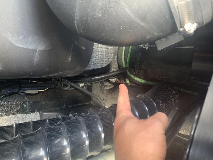

                      Same issue my starboard ballast sensor is toast . Still struggling to find ballast sensor plug to unplug until I can get it replaced . Looked around a stringers for plug but no luck
                      At the *** end of the engine compartment.
                      • GMLIII
                        • May 2013
                        • 2821
                        #41
                        Ok thanks for the visual, this helps . This looks fun , hope the Easter egg hunt does not consume most of my Sat .

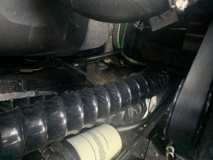

                            Here is a visual of my ballast sensor with high voltage . My starboard ballast sensor is toast and done. Always states 100% full when there is zero water in starboard ballast tank
