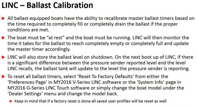

                      Came across this for 2016 models. I am sure it applies to most LINCs
                      2012 SANTE 230

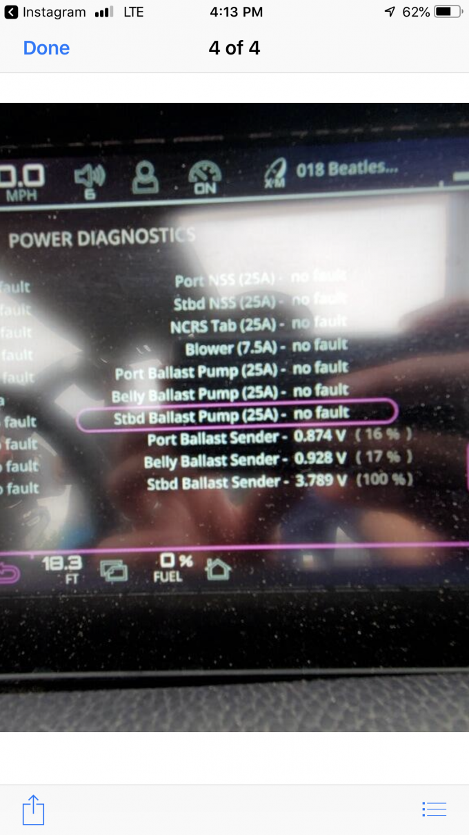

                              It needs a new sensor. They get water inside the connectors and Corrode internally. Nautique still doesn’t have a real “fix” and will continue to pay for replacements until a better sensor is obtained. When the ballast reads 100% and you know it’s actually empty, scroll down to the settings screen and then choose a screen that I believe says “power diagnostics” tell me what the suspect sensor voltage reading voltage is in the lower rh corner of the screen.
ID:	584205 I took a pic. look at voltage. There was a g23 nearby and I asked for readings. He had all 0.9ish.
