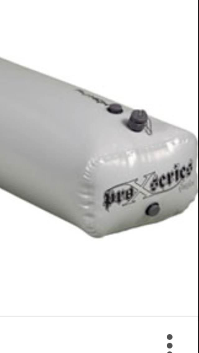

    Recently sold my 01 210 and brought a 2013 210 with stock ballast. I intend to do the piggy back method, adding extra sacs to the factory tanks. My only question is with the extra sac I am going to install in the ski locker.
    Do the fill and vent holes of the ski locker sac point up or down? So are the hoses at the bottom of the sac or on the top? The reason I ask is if they are at the top then how will the water drain out? The rears will gravity feed into the tanks but as the ski locker sac is more between the 2 belly tanks I assume it will not gravity feed?
    Does anyone have a photo of their belly ballast piggyback?
    I know there has been many posts on this but I cannot seem to find a single post that states sac orientation in the ski locker.

ID:	506505 I have a bag in my 09 210 ski locker piggybacked off the belly tank. The fill/drain hose goes technically in the back/side of the bag but at the bottom of it and the vent hose goes to the top of the bag.

      Thanks for your response. Mines a different bag but will work the same. My thoughts around this was that the vent on the stock tank is at the top of the tank then if the bag fill is at the bottom then there's a chance the bag wouldn't empty. Obviously it does if you have yours setup in that way.

        The bag will empty for sure. I have mine set up the same
        way. Piece of cake to install. You just pop off the front drivers side cushion to access The overflow.
