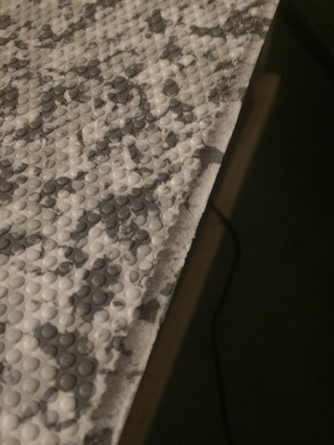

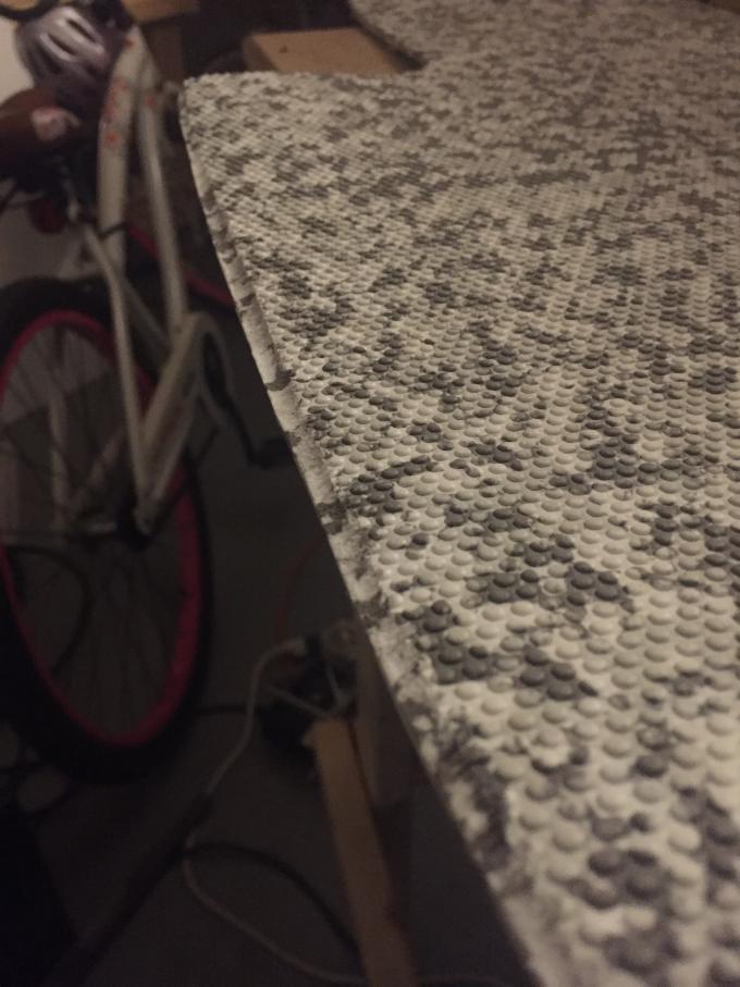

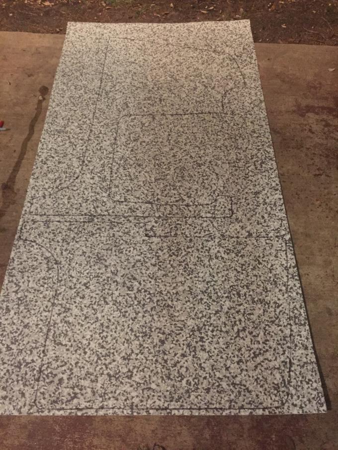

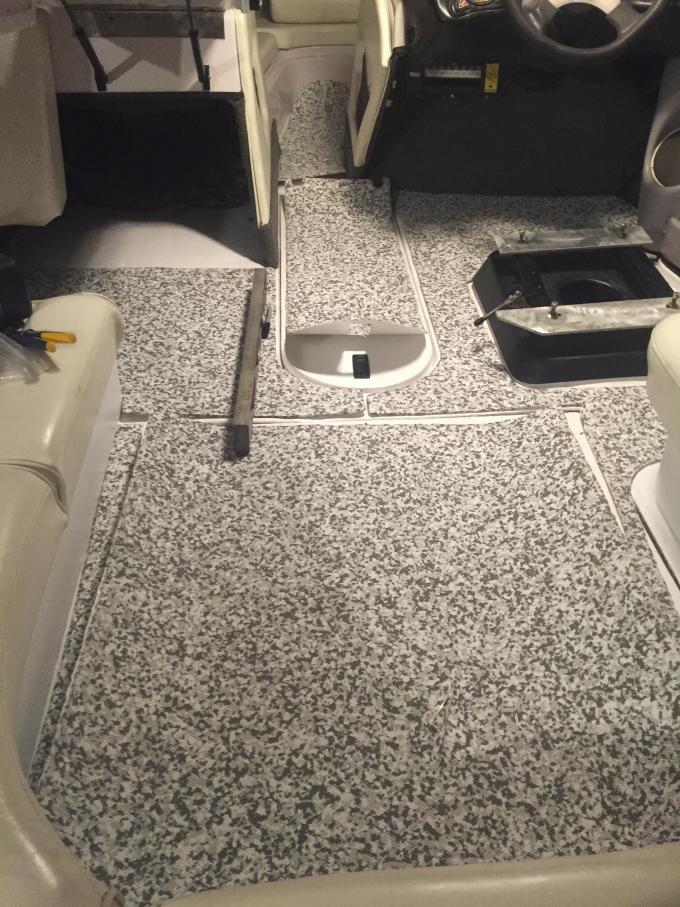

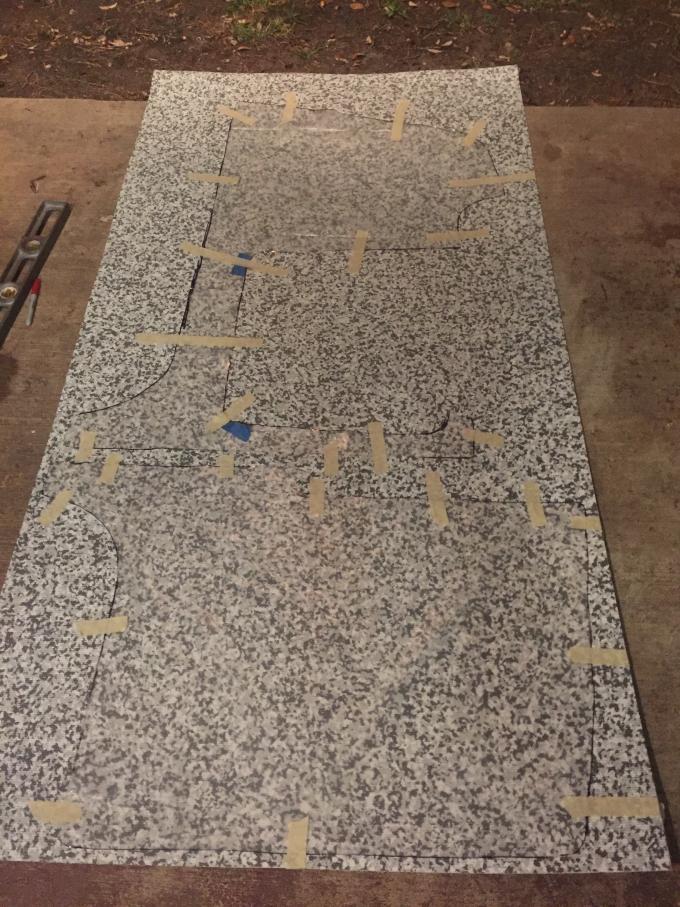

I started doing my boat last night. Here are my 2 cents. Use mylar to template. I used basic plastic sheeting and it doesn't lay quite as flat. Mylar is more expensive but will make it easier in the long run. When making your template use a straight edge as much as possible. Freehanding may look smooth at first, but when you go to route it it won't look even. When cutting, cut the template to the line, tape to the sheet, and then outline with a thin sharpie. This will get rid of any chance of the template moving. Use a straight edge and razor or very sharp scissors. I actually prefer the scissors. When I set up my router, I used a 1/4" cove bit. 3/8" cove bit may work as well. Set up a vertical and horizontal fence. If the sheet doesn't have the proper down pressure, it will cut shallow. When freehanding with the router, I just left it on the table and pulled my fences and very carefully cut the edges keeping my hands clear. Be careful not to push to hard or the sheet can slip off the roller bearing on the bit and gouge the sheet. After making a few sheets, I am not suuupper happy with the quality of the edges, but overall pretty please with the improvement over carpet. The up sides to doing this yourself is it will be overall faster (no wait time shipping to Seadek and waiting on your sheets) and it only cost me $260 vs $1200+ for the sheets. I only used two sheets. and covered almost my whole boat. Downsides are the edges are a little sloppy, no faux teak look or multi colored edges, and it took more personal time myself. It took 3-4 hours to template and will take almost 6-8 hours to cut, route, and stick down. I can post pictures of my results when I am done. If you are not picky about your boat looking purely factory and cost is a big factor, diy is a decent option.
