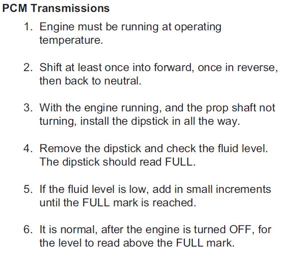

What's the proper method for checking the level of the new fluid? Do I push the dip stick all the way in, fully seated or only to where the plug on the stick rests on the drive? Same for the tranny fluid, do I push the dip tick fully seated or only to where the plug rests on the block?

The transmission is a bit more complicated, but here are the instructions (for the PCM Transmission) from the Engine Owners and Maintenance Manual. The instructions are a bit different if you have the Hurst transmission.
