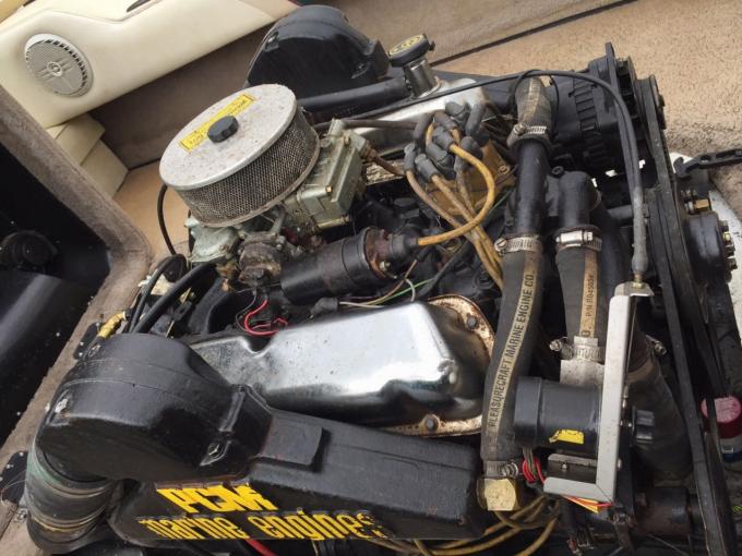

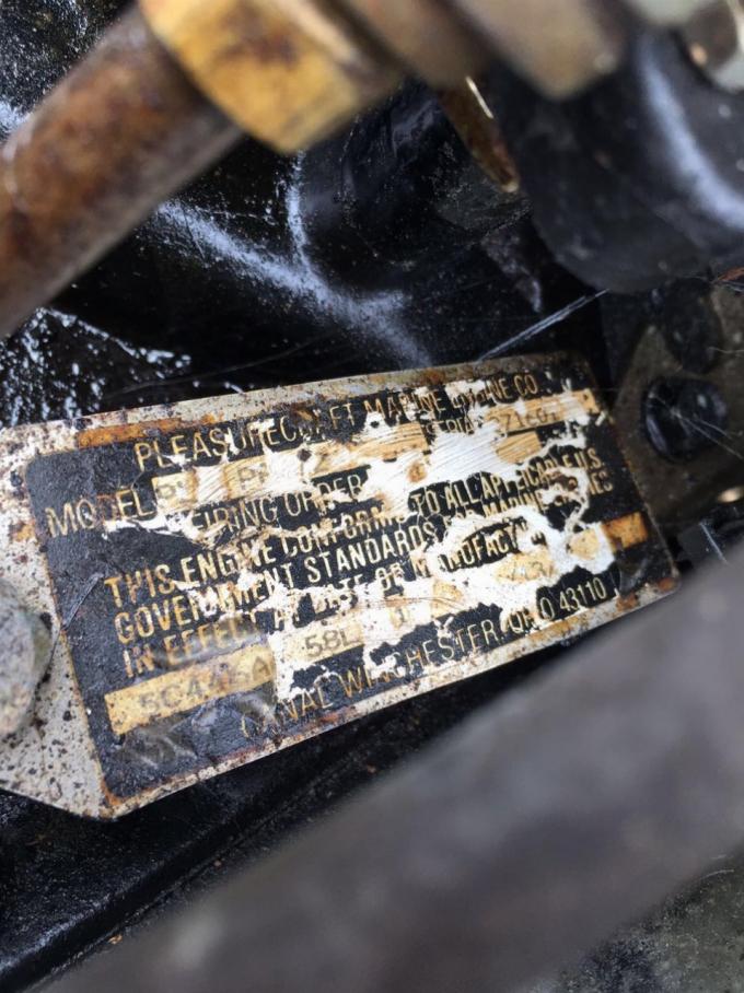

Hi, Just bought a 1997 196 Masters Edition with Perfect Pass as a project and am trying to identify the engine from photos as I don't physically have the boat yet. You can no longer make out many of the numbers on the engine id tag which makes things a bit tricky.
To complicate matters, the Nautique factory build sheet shows the engine as a 285hp model but I thought that the HO Carb model 351 had red valve covers? The brochure for 1998 (can't find a 1997 brochure) shows the carb options as 260hp or 290hp and the photo of the 290hp engine shows chrome valve covers so maybe it is a 285 (290) after all? Odd that the brochure refers to 290 and the factory build sheet to 285 unless the output was tweaked slightly between 1997 and 1998.

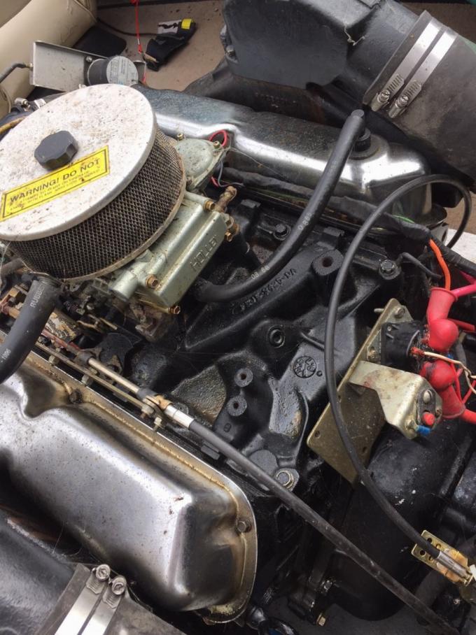

The engine top cover has obviously been lost.
I tried emailing PCM but they suggested it could even be a 302 and that wasn't even an engine option for this boat so it must be a 351. As far as I can ascertain, the engine hasn't been changed since new hence my confusion. Can anyone help?
