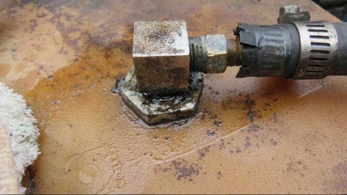

****, trying to pull the pick-up out of the tank but no way to unscrew the **** thing. Are these (see pic) supposed to separate in the normal direction or do these happen to go reverse?

Ya it should ypur right. Iv never pulled the pickup out of tank it likely has sealant in the threads and is bonded to the tank. You should be able to put a vacuum on the fitting and check it to see if fuel comes out. Vise versa if you blow into that fitting it should shut as its a check valve only allowing fluid out and not in.
If you can blow into it then the check valve has failed and you'll need to replace that fitting or fix it if possible.
Disclaimer: For safety I'd drain the tank before testing with a vacuum if you use any electrical vacuum pump. Or just pull the hose off after the low pressure fuel pump and then just turn key to accessory position and it should turn the pump on and you'll see fuel come out of the hose. Assuming your fuel system is the same as mine with the low pressure and high pressure pump?

I've undone both of my tank fittings, one large adjustable wrench on the hex tank fitting to stop it breaking free of the bond to the tank and one on the square of the fitting, its a normal NPT tapered thread (not reverse) so you'll need a sealant - I used Quicksilver Perfect Seal as I had that lying around, but you don't want to use PTFE tape as bits can end up in the pump, etc.
The anti-siphon valve is a ball bearing + spring set up so you can clean it pretty easily with carb cleaner and the pickup tube does have a gauze on the end so it's worth checking that for blockages, especially if the tank has been run dry
