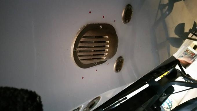

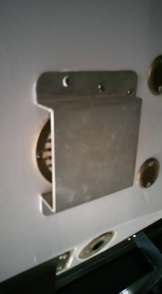

I just purchased a new G-25 with the 550hp PCM engine. The operating temps shown on the LINC are running between 170 and 182. Water temp is 85, air temp is 88. I have a diesel in another boat and 180 is correct, but my gasoline engines generally run around 160.
The 550 tends to run hotter than the other engines. There is a scoop that can be added to help with the cooling. Your dealer should be able to add it for you if you don't already have it.
