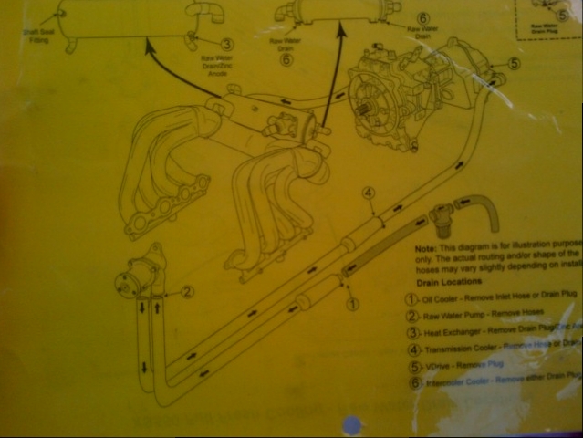

      Call PCM customer service and ask them to send you this yellow winterization chart for your specific engine setup.

                      Hi all! I picked up a 2013 G23 in and love the boat. Freak (somewhat although it is Canada) cold on the way so I’ve made a bit of a panic trip to the lake as my boat is out and on the trailer and we’re going to minus 7 Celsius (20 Celsius or so) over the next couple night. Don’t think it’s enough to do damage but don’t want to take chances so although a new boat to me I’m rush winterizing. Block / heat exchangers / ballast and heater no problem but can’t imagine how i’m going to get to the oil cooler or transmission cooler given their apparent placement on the water chart. I can touch then and wrap my hand around at best can’t imagine getting a wrench in either. Wonder if I’m missing something is there a way to run some antifreeze or something in lieu of getting at them to drain?

                        XS550 engine by the way. Both coolers appear to be way down under the engine.

                          Yeah, due to where placed on my g21 zr409 i can't get to my engine and tranny oil coolers either. What i do is suck in rv antifreeze first, then drain everything i can reach. I would just suck in rv av and not drain but on my engine it has exhaust manifold thermostat so i gotta drain manifolds as no way to know if exhaust manifolds have water or rv av. Kind of backwards to suck in rv av then drain, but that's what i do. gives me peace of mind when i see pink rv out the exhaust at back of boat and when i drain what i can reach.
                          also, what is nice is if you suck in av antifreeze you also skip the v drive drain plug.

                            I so live in Alberta. What I have done last two years is the easiest way. Dry run ballast till no more water comes out. Then I have T’d into my main water seacock with a valve and a garden hose connector. Get about 8 gallons of rv and suck it all up and run it through the boat. Also before I run the rv through I run the boat till no more raw water comes out the exhaust, maybe 30 seconds. As far as exhaust thermostats I have taken mine right out of the circuit as it serves little purpose and caused me more issues than anything.

                              Yeah, that is a good way to go too. You probably don't even need to bother running the boat to get the raw water out first. If I was doing your way I would skip that to keep the raw water pump primed. I gonna think about your way. I think I am too nervous not to pull plugs...but that's just me...
