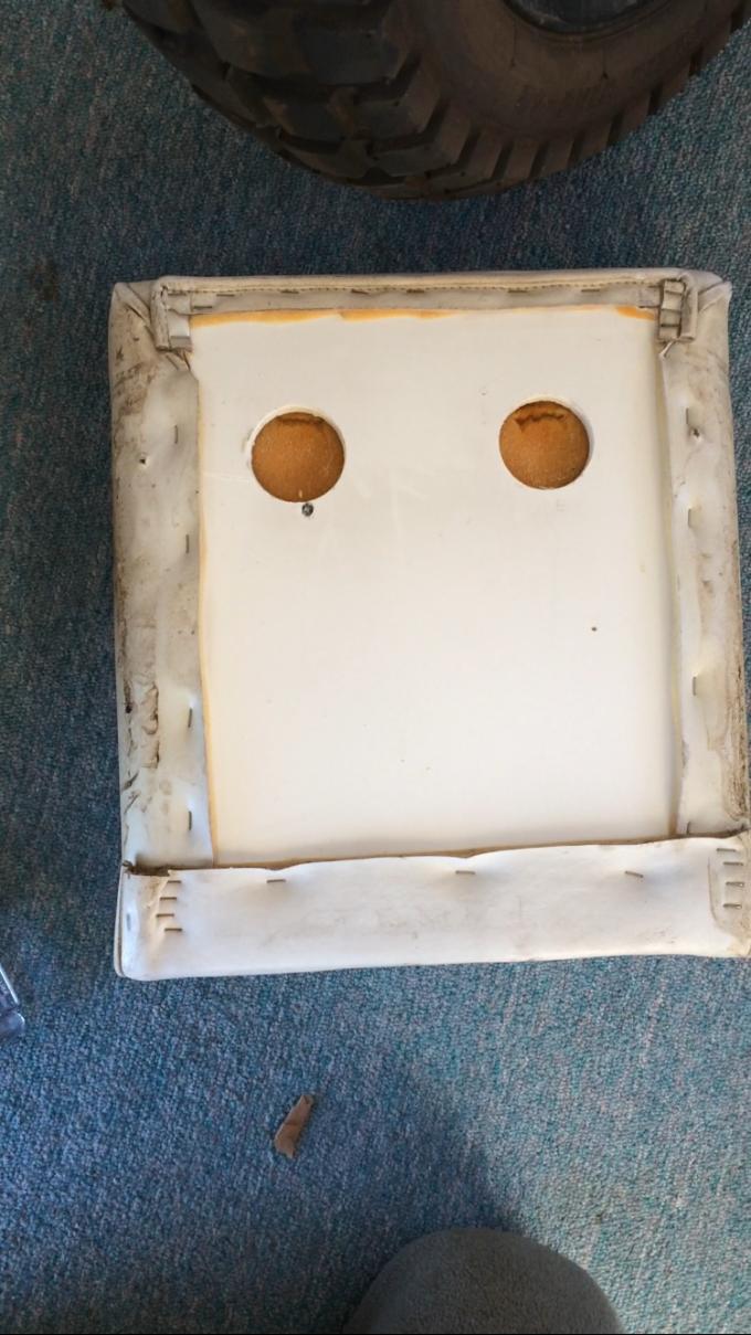

    I purchased a new skin for the captain's seat on my 2008 SANTE from NautiqueParts. The upholster shop I am having installing it is have a difficult time figuring out how to get the back cushion off the seat, I guess it is a separate piece. Does anyone have the seat drawing or have experience in tearing the seat down? I am looking for some suggestions.

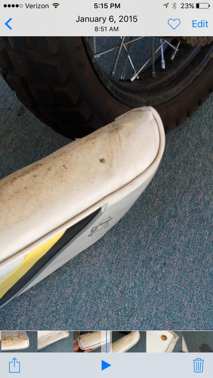

    I did the captains seat in my 2002 SAN. Got a full boat skin set made from Christine's marine. On mine the back pad was separate from the seat and the top of the back rest pad had two 1" holes drilled in it that hung on two metal posts that were part of the seat itself. In addition to keep the backrest from being lifted off they put a screw on each side of the backrest that went in at a diagonal angle from the side through the upholstery (where you wouldn't see the hole because it was on the side and was hidden when the backrest is installed in the seat frame). Look on the sides on the backrest for holes in the upholstery then fish a Philips head screw driver in the hole and start feeling for a screw head. You can see the hole on side of my backrest here in pic. Your 08 may be different not sure.....

      Thanks for your help. I will pass the info on. The pictures are very helpful! Hopefully they can find the screws.

        We found the grabber screws, there were three of them, one on one side and two on the other. The back slid right out after we removed them. Thanks for your help!!
