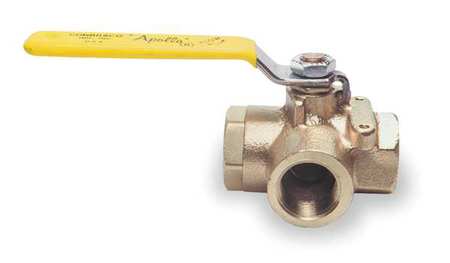

    I have been having a few issues with my boat and putting it in water every time I want to test it isn't ideal, so I want to see what everyone is doing for cooling. I usually disconnect the hose above the valve and drop it in a bucket, but I have concerns about the about the water pressure while raising the RPM's. I have seen the kits you can buy for this, but I don't like the plastic they are constructed with. I have considered switching the shut off valve under the water strainer with a 3 way valve where I can switch the source to a hose, but am not sure if it will work. The picture below is similar to what I was thinking. Does anyone else have ideas, concerns, or suggestions about doing this?

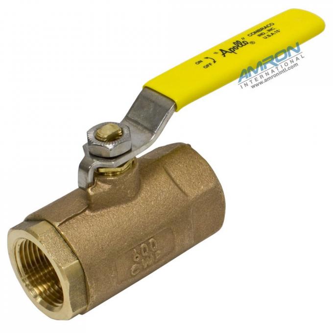

          I have the exact same concerns you mention, and that's why I would prefer the brass valves instead. There must be a reason why no manufacturers (at least that I know of) add these flush valves from the factory. The check valve is unnecessarry if I will be in there anyways to hook up the hose because I would only be adding the one step of turning the handle. My current setup is hull intake, 45 deg. elbow, shut off valve, hose, then strainer.

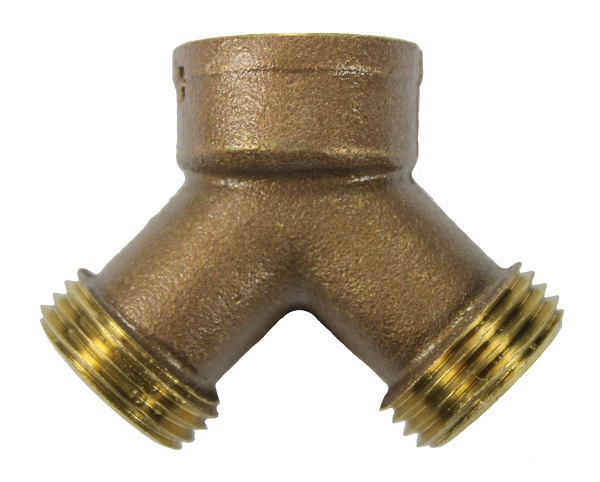

              I've always just attached a Y fitting on my hose, connect a second hose attached to the downstream side off of the strainer.
              Turn the hose on full blast and then start the boat, all the pressure blows out the open side of the Y fitting till the boat is running then the fresh water pump pulls all the water it needs and the open end of the Y is reduced to a dribble. Once the engine is off all the pressure goes back to the open end of the Y fitting.

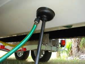

                these things are stupid simple, have never had a problem if you can access your raw water intake. over pressure blows out from around it until boat is started. don't really rev the engine, just idling until warm enough to service. Click image for larger version

                    Those devices are called Fake a Lake, and yes they work awesome we use one up here to winterize the boat as well as run it first thing in the spring to clear the antifreeze out and make sure everything is working properly before it is put in the water for the season. We use it on all our boats here.

                        Yea, just use a Fake-A-Lake. They're cheap and work like a champ. Plus there's no need to install any fittings in your boat.
                        Just go with a simple solution.
