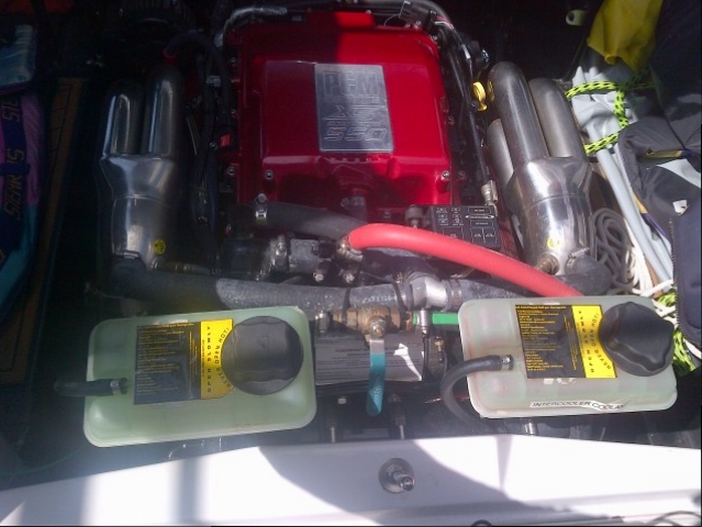

Nohlan, can you post up a pic of the housing that holds that screen?2019 G23 450

This might do it...found a contact at PCM by working with DIM when I was servicing mine (2013 409) and was trying to figure out exactly what to do...the screen was partially clogged and was curious if I could take it out and replace...was surprised that the anwser was to remove completely
Sent from my VS985 4G using Tapatalk
