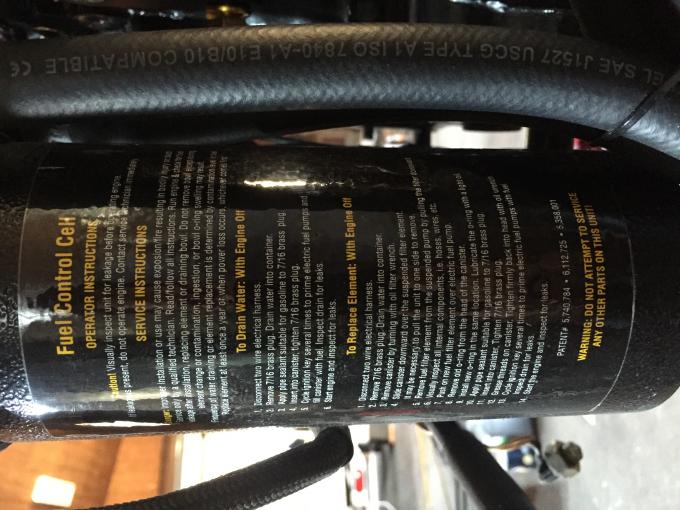

Here is pic of FCC fuel canister and the sticker with instructions you need.
Am I correct in assuming the FCC and the high pressure fuel pump are the same thing? I'm going to go to the lake after work today and try to pull it off the boat. Anything special to get the FCC off the boat?
Should be able to unscrew the canister without removing the canister bracket and everything. May need to move some hoses out the way to pull the canister all the way off and expose the filter and pump.
