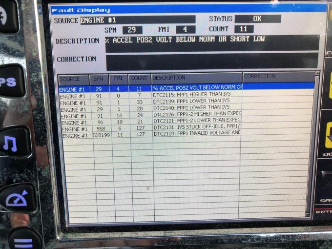

    I have a 2008 SAN 230 with the 390 engine. It only has 170 hours on it. I bought it in 2015 with 74 hours on it. It has been running great but recently the check Engine Light (CEL) has been coming on, seemingly, randomly. During use, the CEL will come on and sometimes quickly go off and other times it takes me backing off the throttle and coming back to idle before it clears. I took it to the dealer to read the codes and they told me the following:
    2140 TCP2Low
    2126 TCP 1&2 High
    I told them I wanted to do my own research about what this was simply because it seems to be a blackhole sometimes with dealers to figure things out. Anyways, they did not have any immediate insight as to what this is.
    I saw one post that said it may be an issue with the Throttle Control Position Sensor. Does anyone have anymore feedback about this?
    I've put about 20 hours on the boat since this has been happening and it has not had any negative effects, that I can tell. No loss of power or different sounds of note.
    Any help is appreciated. I am an Engineer and pretty handy. I'd prefer to fix it myself but don't want to start throwing money at a bunch of parts.

    I've been doing some more research via PCMs manuals.
    It appears the codes are related to the Throttle Control Position (hence...TCP) rather than the Throttle Position Sensor (TPS). From what I am reading, it appears there is a redundant set of throttle controls (FPP1 and FPP2) that get sent to the ECM. They are redundant to ensure the engine does not get a false signal (I assume). Anyways, the ECM appears to evaluate these signals and throw an error code if they too much different (more than 20%).
    2126 indicates that FPP1 is more than 20% greater than FPP2.
    2140 appears to be indicate that Idle Validation Switch is off AND FPP1 is having a voltage issue related to a short.
    I think I follow that, but if I change out the TCP and I still have a short, I would think I would still have a problem. I wonder what is causing the short?
    Thoughts?

                      I have a 2012 sante 230 zr6 409hp with the dtc 2140 came up most times accelerating dtc 2126 stored counts but I never saw that one set. I had the RA119005 picked up the RA 119005A. The dealer said the ECM doesn’t need to be recalibrated unless I had an o2 code. So even though the instructions that come in the box with the RA119005A state recalibration is required I put it in and so far so good no more active codes or CEL.
