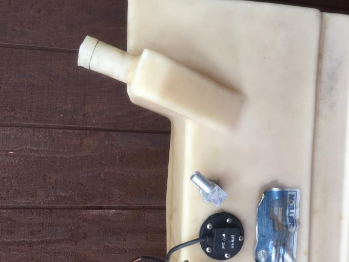

            There are several fittings on the tank itself one does have a check valve but I'm almost positive it's the fuel feed line to the pump. I'm headed out to my boat today to look at it and twiddle my thumbs, I'll take some pics of fuel tank and the vent fitting and check it for a check valve. Again almost 100% sure it doesn't have one on the vent though.

                      No check valve in vent hose or vent fitting on tank
