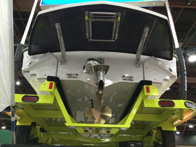

    Anyone have an underside picture of their swim platform ladder on a 2014-2016 Nautique. I order one from nautique parts, just trying to figure out the proper mounting distance from the back/front of the platform. If you could measure this distance that would be even better!

        Here's a picture of mine. It's a 2015 SAN 210.
        i can get the measurements this weekend.
          AWESOME! This is just what I needed, thanks!
