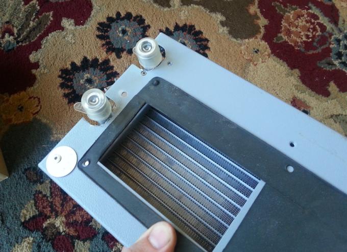

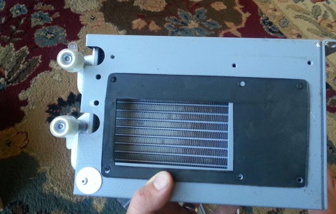

                Here's what I wound up with from Napa. I had to drill out the rivets on the sides of the heater box that were holding a kind of little bracket thing that the old heater core slipped between (like to keep it from shifting around in the box). The new core slid in so snugly that that's not going to be an issue anyway.
                Then the little "U" cutouts for the inlet and outlet didn't line up exactly... super close:
Name:	Screen Shot 2016-07-19 at 12.25.33 PM.png
                So I had to take a dremel to those "U" cutouts. No big deal:
Name:	Screen Shot 2016-07-19 at 12.25.07 PM.png

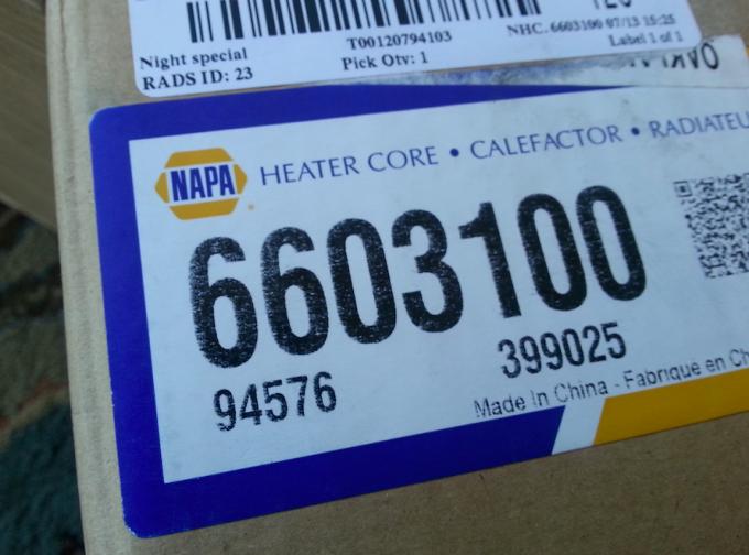

                $28 at Napa. Here's the part #
Name:	Screen Shot 2016-07-19 at 12.25.16 PM.png
