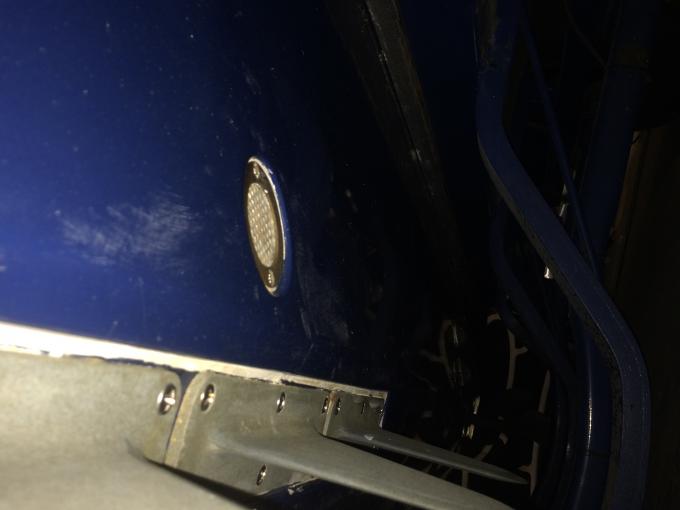

    I'm not sure if this matters, but on my through hull inlet on the belly tank, it uses this flat screened piece. The rear tanks utilize what looks more like the "scoop" style of intake. Is the front intake the OEM?

          Also rhat center one is flat so it doesn't get bent while loading in the trailer or a boat lift. You don't have the scupper style there or it will bend.
