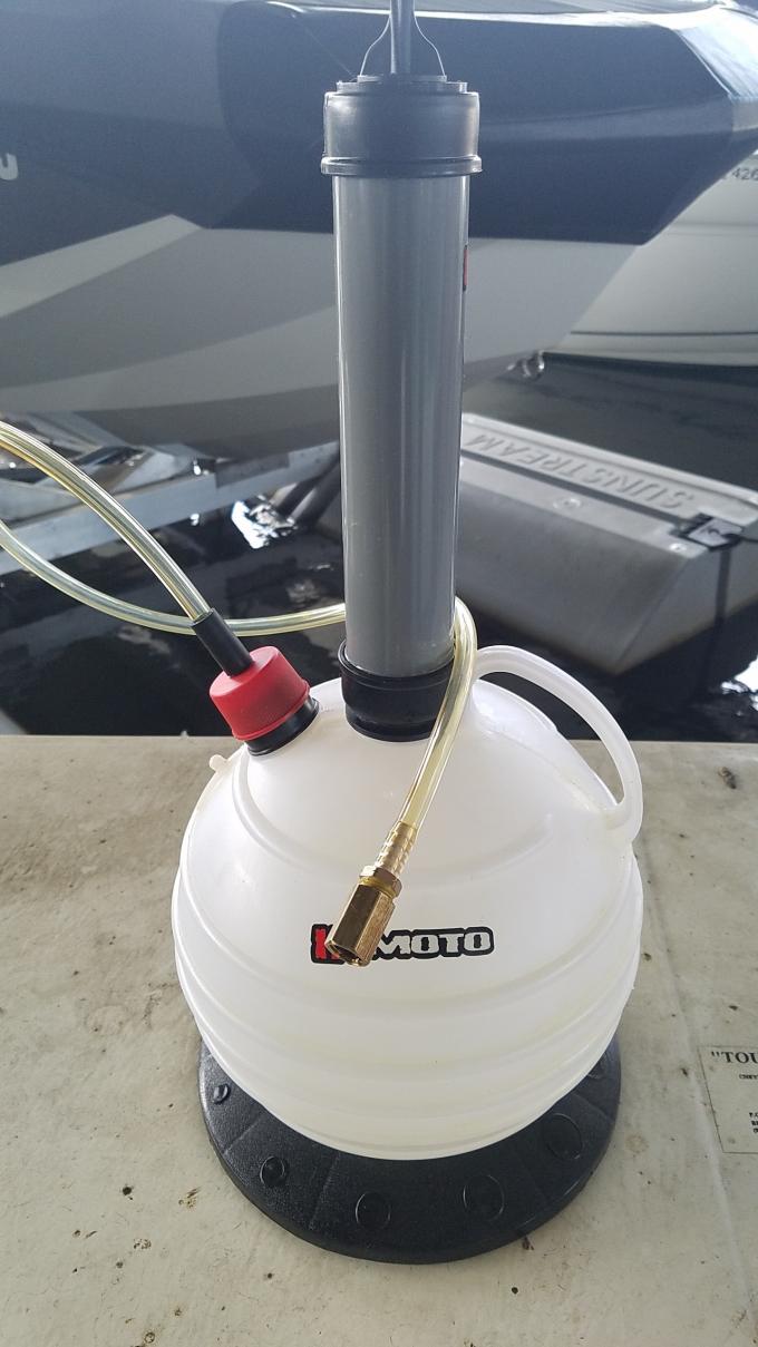

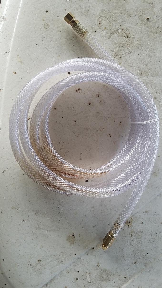

            I'm the same way! You can do this but only if the boat is out of the water. You will need to build an extension hose that connects to the drain hose because the current drain hose is not long enough to reach the drain plug. You can find the fittings and the hose at Home Depot and build an extension hose that screws into the factory drain hose to reach the drain plug. However you will need to let the engine drain over night (at least) because the oil will run very slowly with this length of hose. I tried it and it took over 12 hours to completely drain the oil (in the spring temp of 65 degrees). Expect faster for summer time.
            However I believe it is much more efficient to get an oil extractor and build a hose connection to connect from the oil extractor to the engine drain hose. This way you can pull the oil from the engine from the drain hose which is at the lowest point in the sump pan. This can be done while the boat is in the water too so the oil can be hot. I prefer this over using the dip stick extractors because the dip stick does not always guarantee reaching the bottom of the sump.

                  Finally, I thought I would show pictures of my oil drain extension hose and the oil extractor that I configured to connect to the oil drain hose of the H6 engine. The extractor works great and takes about 30-40 min to change the oil ensuring I pull out every drop of used oil. The only downside is this particular extractor has a limit of 6 qts, so I can't pull all of the oil without stopping to empty the extractor tank (oil capacity is recommended to 7qts). But at the time I could not find a higher capacity oil extractor that would easily adapt to the fitting for connecting to the H6 engine oil drain hose.
                  Here is a link to the oil extractor: https://www.amazon.com/Powerbuilt-64...pd_sbs_263_3?_ encoding=UTF8&pd_rd_i=B00OCEGONC&pd_rd_r=69HTZ5WEN 08Q8EBT6ATZ&pd_rd_w=XohY2&pd_rd_wg=1JOMJ&psc=1&ref RID=69HTZ5WEN08Q8EBT6ATZ
