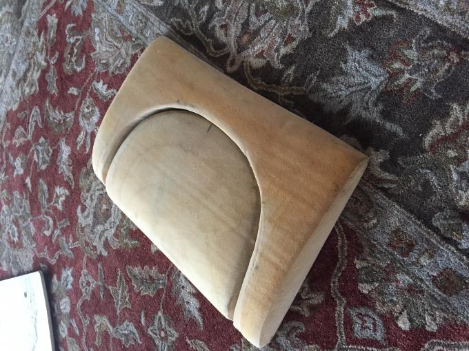

Hey, foam brand won't really matter all that much with the exception of quality. Just make sure you get marine grade foam. All you will have to do is add a backing on the seat support, cut the foam to shape, glue it in, and use some form of batting. If you don't it will show through that there is a circle there.
Here are two pictures that show how an outline can come through on new vinyl.
Without batting (see the circle outline I had)
With batting, really cleans it up so there aren't any lows in the foam.
Obviously this is a bit bigger of a fill than a speaker hole, but same principal applies.
I hope that helped. I'll dig through and try to find some foam after work and post the links for you.
-Pat
