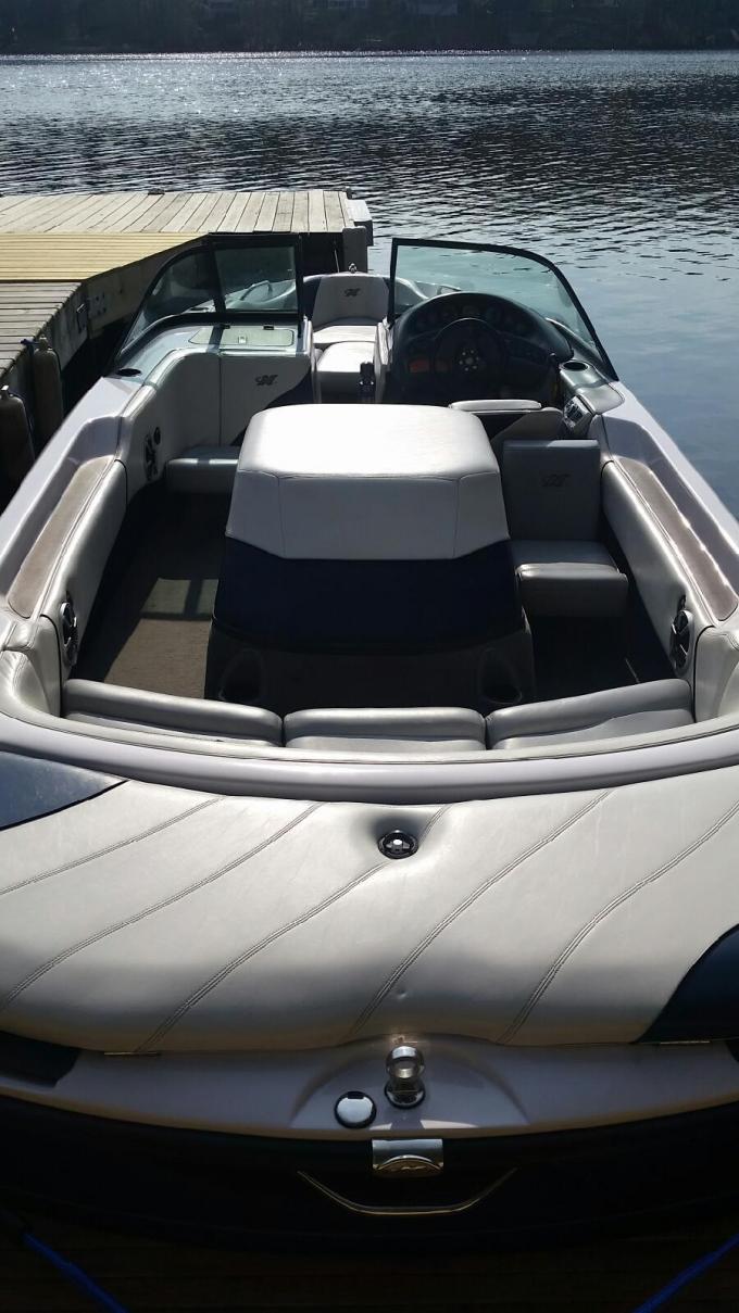

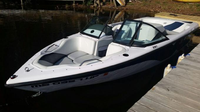

    3rd - Not completed yet... moving all batteries (3) to the back of the boat.
    Pictures for those interested.
    Second UPDATE
    By the end of this past season I had managed to move all 3 batteries to the back of the boat under the rear hatch opposite the driver... almost 200 lbs of batteries in a custom enclosure.
    Made a noticeable difference in the way the boat handles and also leveled the way it sat in the water, always listed to the right by about a 1".
    The nose rose out of the water a solid 2 inches sitting unloaded. Hole shots were much improved as was plane time, not that it wasn't a beast before that.
