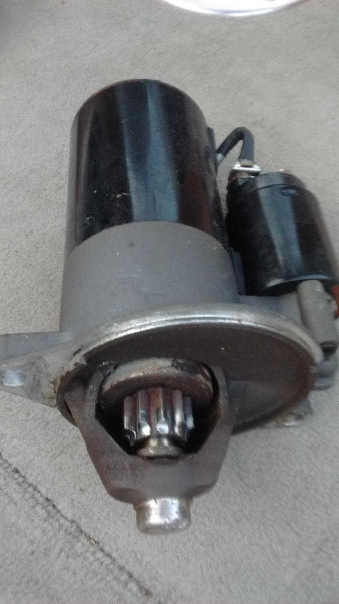

    Good news, I was able to start it today. My starter locked out so I knocked on it few times and engine started. Prop spins in both directions so it is not a transmission but I still have a grinding sound somewhere around transmission and engine area and it sounds like starter's flywheel is not disengaging. I m gonna check starter tomorrow. Anyone had similar symptoms?

      It's a starter, I'm a lucky guy. Just look how those teeth are grinded Click image for larger version
