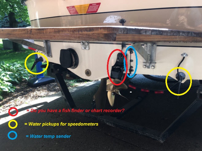

We have a new to us 99" pro air, not getting consistent depth reading and the depth sounder beeps loud anytime we get no reading or less than 5 feet of water! Anything I should check to fix it? Here's what the back looks like, what is each side for, and the center sounder? Which of them do depth and which does temp?
