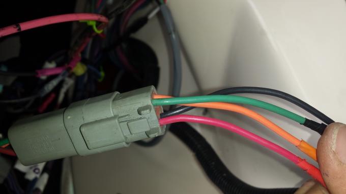

    Looking on input on which wire would be the ignition switch wire at my keyless pod. Device has a function to assist starting and i need to connect ignition switch wire to it.
    I attached pic of a plug with four wires that connects to keyless pod. I know that red is 12 constant and black is ground. I dont know about green and orange.

    Why not make it simple and just use the COMBINE position on the dual battery switch?

      My battery switch has on and off position only

        I ended up using a wire from the starter solenoid. Works great

          I would highly suggest replacing the single bank on/off switch for the dual circuit plus dual bank switch. Much better suited for passing starter current, rather than through the sure power solenoid. Allows for all loads to be disconnected from the batteries when the boat is not in use.
