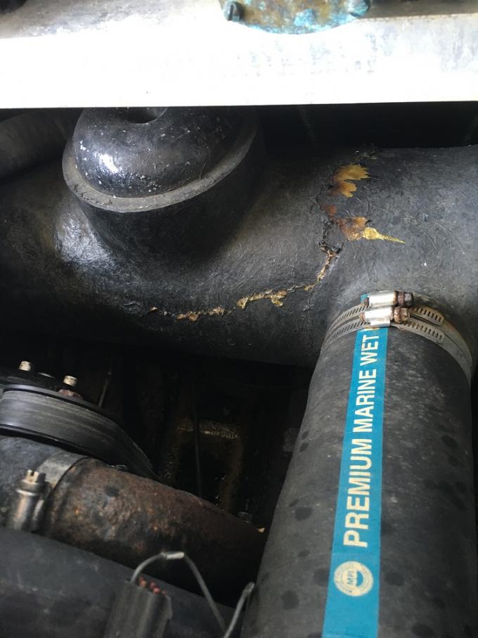

I had the boat in shallow water Sat. Depth read 1.6-2ft for about 50 yards in a canal. The next day with in 10 minutes of being out i smell burning rubber and the boat goes into 'power reduction - see dealer' mode. I turn engine off and notice a crack in the muffler and hear a bubbling noise. Would i be crazy to think that the shallow water the day before was the reason for this? Maybe sucked up some mud that clogged the cooling system? Im going to pull water pump impellar to see what it looks like.
My questions are:
1 - The muffler looks to be fiberglass. Can i take this to a fiberglass shop and have it fixed instead of buying new muffler?
2- Other than the water pump impellar is there anything else that would cause the overheating?
My questions are:
