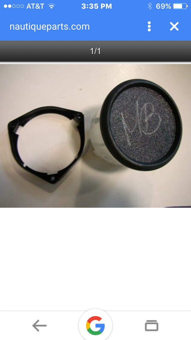

          look up under the dash guys, it was there on my 06 210, IIRC its white and round towards the right side of steering wheel.

          • ScooterMcgavin
            • 1551
            • 2014 SAN 210 TE
            This is the top view that you won't be able to see. Look under and you'll see the white round part of this part.
            Hope this helps
