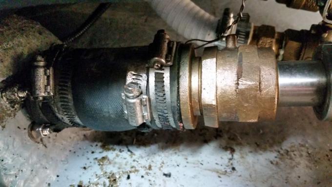

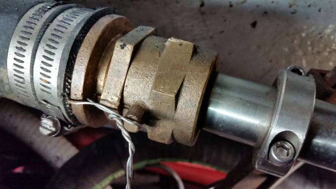

    Hi Everybody,
    I am looking at my shaft seal and to try and tighten it and am having difficulty..
    i have a few questions:
    1. if you look at these 2 picturesdo i have to remove that little piece of wire in order to turn the nut? with a pipe wrech it seems the entire thing want to turn
    2.looking at the other side do you think i still have a few turns left on this guy or is it time to replace?
    3. what do you use to turn this? pipe wrech? do you have to hold one side in order to turn the other one?

    The wire is a safety wire to prevent the larger collar from working its way loose. Undo the safety wire. The smaller jam-nut needs to be loosened first (back it off the larger collar). Once the jam-nut is loose, then you can tighten the larger collar.
    I have two big channel locks that I got cheap that I keep in the boat. They have teeth which has its good and bad points. If you want, go look for some giant adjustable wrenches.
    I check it twice a season...and I know how much water I get in my bilge for our usual outings. I think the rule of thumb is a few drips per minute. You don't want too few or too many. Look at what you have going on before any changes and then look after you make changes. Sometimes I have my wife drive a bit before I rewire.
    Dave
    • shag
      • 2217
      What Dave said..... And I've always used the 8-10 drips a minute.. some might say that's a bit too much, but works for me ..... Be sure to put the wire back on.... And if it breaks you can get Stainless wire from Ace hardware....
