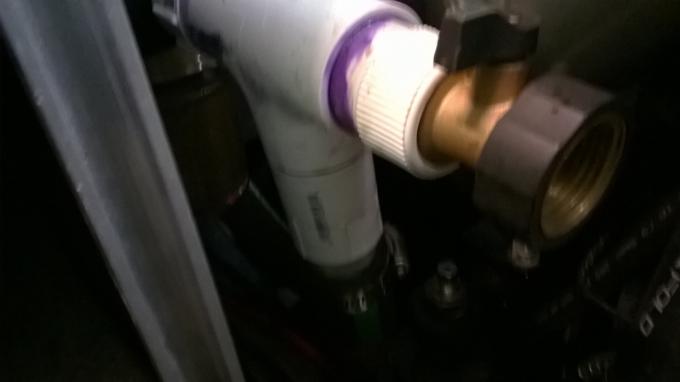

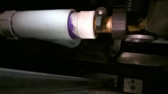

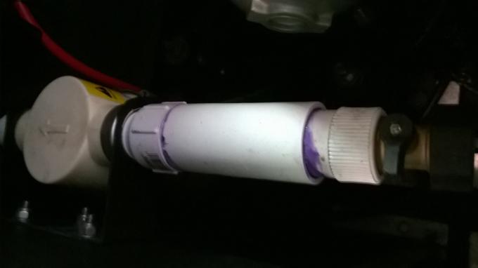

        I just replaced the elbow on the in side of the strainer with a tee ,valve and garden hose female adp. Works great hook up the hose turn the water on the water will come out of the raw water intake . Start the engine and give a little rev the raw water pump will suck the water in to the engine. Click image for larger version

          I just replaced the elbow on the in side of the strainer with a tee ,valve and garden hose female adp. Works great hook up the hose turn the water on the water will come out of the raw water intake . Start the engine and give a little rev the raw water pump will suck the water in to the engine. [ATTACH=CONFIG]n479601[/ATTACH] [ATTACH=CONFIG]n479602[/ATTACH] [ATTACH=CONFIG]n479603[/ATTACH]
          I wish I could do this....however I think I too will have to go the trash can or large container filled with water first route as I don't think my house has enough water pressure available.. esp if I used your set up where some of the water may make its way back out the intake instead of up into the raw water pump. Good on you though for finding a cheap solution. I could do this same thing and just extend a 6' or so piece of hose into the trash can to suck up the water. Would just need an extra valve to shut off the intake side.
