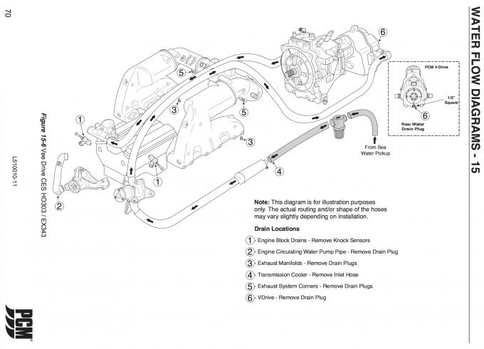

Has anyone winterized the 343 themselves and/or have photos/suggestions. I am a good ways away from my dealer and need to do it myself. I have previously winterized all our other nautique boats, but since this will be my first time on a our 2015 SAN 230 just wondered if there were any quirks or unique things to be aware of. Its an open cooled system with no heater.
You need a big crescent wrench fit the manifold plugs. It's pretty straight forward. Your manual has a great diagram of exactly where all the plugs are in the engine. Just don't forget the ballast system.
Here you go.
The diagram is a little vague when it comes to #1 (knock sensors). Just make sure you take the WHOLE thing out and not just the bolt that holds the sensor in place. I believe you need a 1" or 1-1/16" wrench. I also take the water and ballast pumps apart to inspect/change the impellers."I'm on a boat........"
I have never heard that there is a need to drain the muffler. Do you have any documentation that indicates the necessity? Or just doing for fun of it? I think there is plenty of room for expansion of any water in it.
I've just gotten to the draining aspect of winterizing my "new to me" 343 and can't figure out how to get the knock sensor plug off in order to get a wrench on the sensor. Looks like there's a gray lock that maybe needs to be pushed in before the plug can be pulled off, but it doesn't seem to want to budge. Am I missing something, here?'08 Super Air Nautique 210
It's kind of like "child-proof caps" on some bottles... 2 sides are a bit wider, squeeze those 2 sides and it will pull off.Originally posted by jhiestand View PostI've just gotten to the draining aspect of winterizing my "new to me" 343 and can't figure out how to get the knock sensor plug off in order to get a wrench on the sensor. Looks like there's a gray lock that maybe needs to be pushed in before the plug can be pulled off, but it doesn't seem to want to budge. Am I missing something, here?Jason
