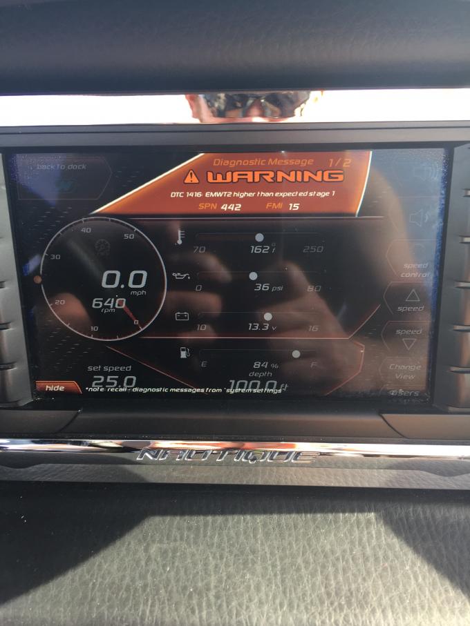

    Just got a new 2015 230 with the 343 and it keeps throwing warning code "DTC1415: EMWT1 higher than expected stage 1" warnings. I read in previous post that this was a known issue back in 2012-13 but I was uncertain if anyone had a similar issue in a 2015? My engine temps were all ok, water intake/outlets/filter are not clogged, so i'm at a loss, other than a defective sensor? Any one else had this experience?

    This happened with my '12 210 TE with the 343. It was a factory defect that PCM corrected by installing new manifold cooling. Same error code, though. The EMWT01 is 'exhaust manifold water temp' which means either the water in your manifold is too hot ( not cooling enough to, manifold is overheating) or the sensors *think* the manifold water temp is too hot... Either way, probably a PCM issue that your local dealer can look into under warranty.
