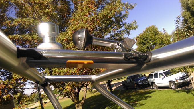

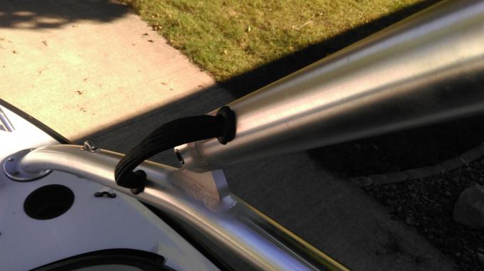

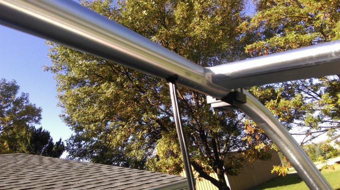

                          Thanks for the help guys, I got all the wires run this weekend and it worked pretty good. Had to make access holes and run dignal from the front bar to the cross bar and back to the back bar. New dimensions told me the tube thickness is 5/32". 1/8" grove thickness grommets worked. I also used some that were a little thicker than that for the bigger holes. Using the braided wire sleeves where the wires go outside the tower really make it look nice.

                            wow, nice job. i was curious how it would go with that many holes to drill, but that looks great.
