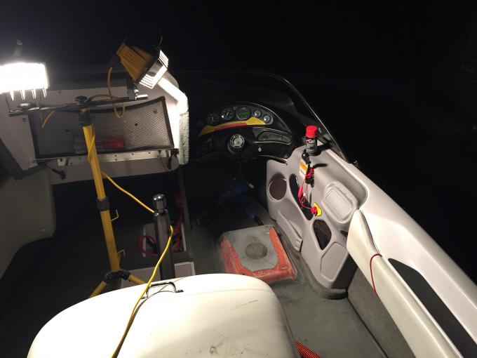

    I just picked up a used 196 with 380 hours on the GT-40. I plan to do some work over the winter, and was hoping to get input on suggested maintenance or preventative maintenance for this age of a boat. My hope is to have it in great form for next summer, and avoid any typical issues that might come up at this stage of life for the boat. Would also love to hear any fun modifications, or things anyone has done and loved on their 196.
    Things done or already on the list for this winter:
    - New steering cable/system already installed
    - Replacing non-working digital Tac/Speedometer Faria kit
    - New Belts
    - Recently replaced fuel pre-charge pump
    - New impeller
    - Replacing stereo/speakers/amp
