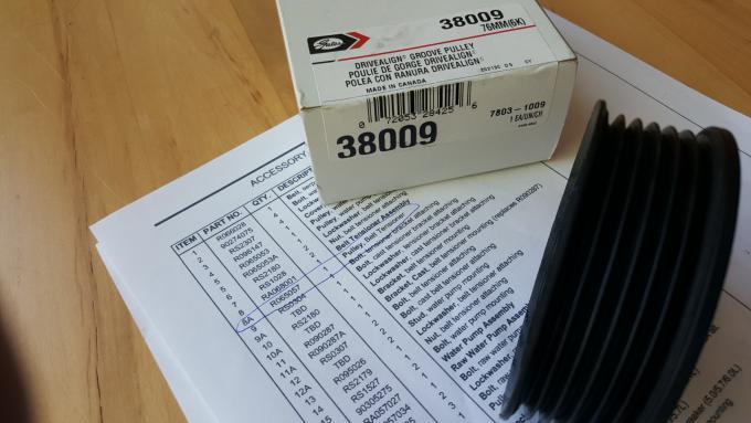

Just thought I would post in case you notice, like I did, some noise with engine running. I identified that belt tensioner pulley bearings were going out. I was able to get exact replacement at O'Reilly for $18. See picture for detail. Easy fix.
Sorry, I don't now about the belt. I have not had to replace mine yet. Maybe someone else can chime in. I would like to know the part# from a regular auto parts store...Oh, I guess, I can also add that my boat had a bit less then 1,000 hours when the pulley bearing started to go out.
