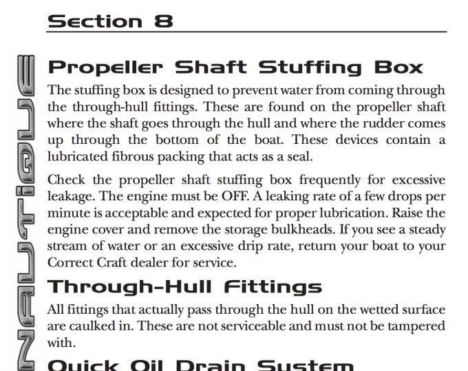

              From your manual:
              Check the shaft packing and the rudder packing, and if leaking excessively, snug them up a bit.
