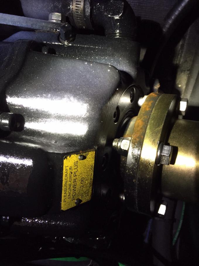

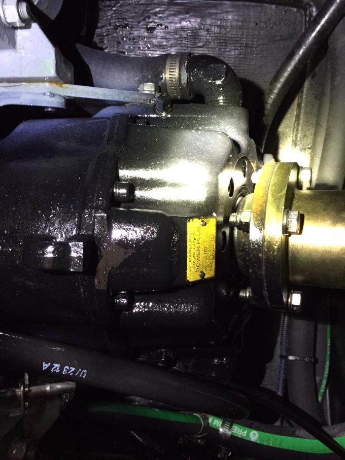

        So this is what I am talking about. If I put it in gear this gold coupling with the through bolts spins but the prop does not and vice versa if I manually spin the prop this thing does not spin.

          I would suggest having your dealer look at it then. Sounds like you may have a more serious v-drive or transmission problem. Maybe broken shaft internal to the unit or the crutch discs have somehow worn to an extreme amount that when engaged they will not create enough friction to move the prop shaft.

              Your shaft is sheared somewhere after the coupler. If it is like most older nautiques, there is a collar after the coupler that should prevent the shaft from sliding out through the gland. (where the shaft goes through the hull)

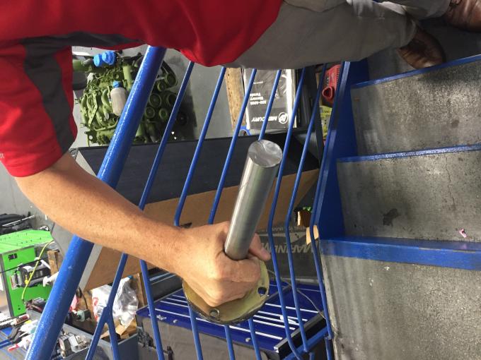

                          Sheared prop shaft. Waiting to hear if it is covered under warranty. I cannot imagine why it would not be. I did not hit anything, nothing wrapped around the shaft etc. I will be very disappointed in the brand if they do not cover it. I know this was an issue on the '13s with the smaller shaft, but this is a '14 with the 1.25" shaft and it happened up by the coupling, not near the prop......

                            There was a service bulletin for shaft replacement on the '14s. We had our boat stored at our dealer over the winter and on the paperwork when I picked it up, it was noted the shaft had been replaced...didn't even have to ask.
