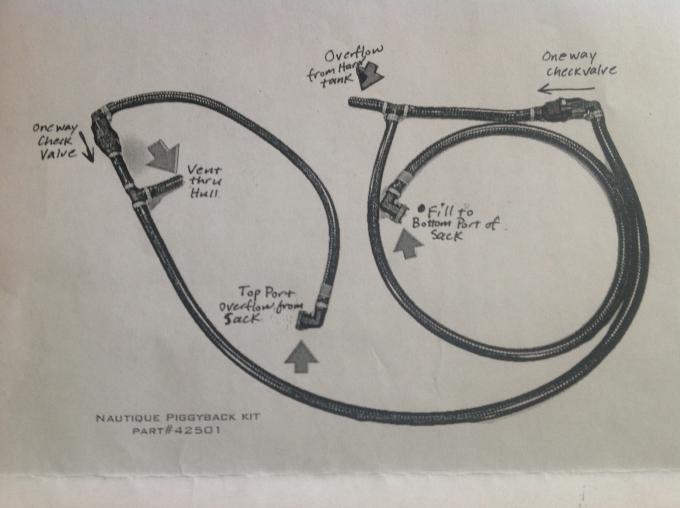

    A few have expressed interest in seeing Wakemakers current piggyback kit with one way check valves. So here is a pic. Click image for larger version

    Similar to what I did, but I replaced the check-valve with a ball valve (the one that is near the vent), which prevents the bag from filling up like a balloon.
