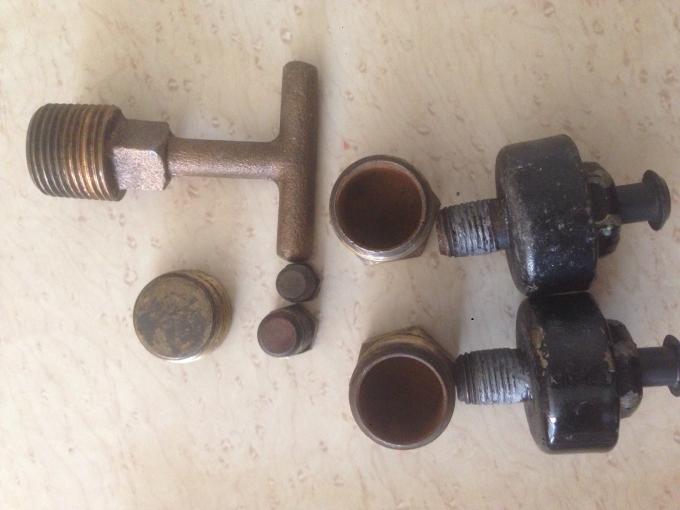

    I Have to leave my house and boat for a little while. I don't know if I'll be back in time to bring it to the shop to get her winterized beforethe first freeze. I decided to pull the plugs just in case. I have a heater so I blew the water out and it came out of the j pipe drain location. I also put anti freeze through the heater hose and watched it come out of the j pipe. I'm pretty sure I pulled all the plugs. Let me know! I also drained the strainer. Thanks guys. EDIT: I have a 08 210 ex343

    How about the small plug on the bottom of the muffler it is on the port side (non CAT motor) near bottom of muffler and the v-drive plug but that may be it in the photo left of the two small plugs??

      I didn't see one while searching. There's a screw on the side of the muffler but doesn't look like a drain location. My manual doesn't state the
      Muffler. Edit: just went and rubbed the bottom of port side muffler and felt no plug. You are correct that is the v drive plug.
