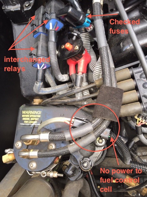

I'm in need of some help! I have a 2006 Air Nautique 226 with a PCM Excalibur 330 engine that will crank but not fire.

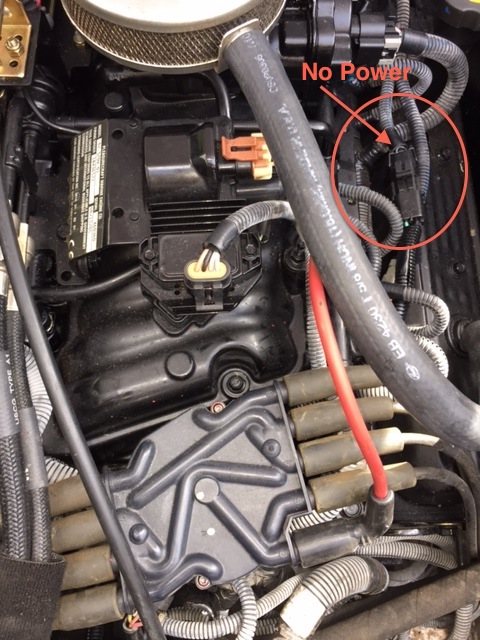

I've ruled out the batteries, the kill switch, the throttle position as well as the relays and fuses located next to the fuel pumps. Determined using a multimeter that the Fuel Control Cell is not getting power. Jump started the relay port to the fuel pumps and determined they are working. Looking for any suggestions as to what else might cause the loss of power to the FCC.
Below are a couple of photo indicating where I'm not getting power and what I've checked.
