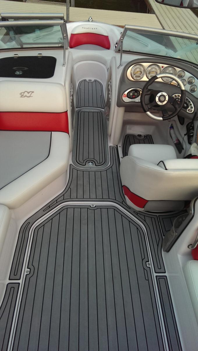

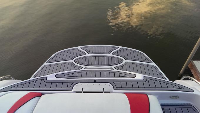

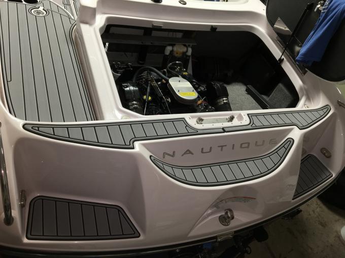

Heres the template i had Seadek build for me on my 2005. Everything fits perfectly as you can see from the linked post above. Many of the templates floating around are for the newer model years that dont have cupholders on the rear step off the walk through. There's also a couple different versions of the transom pieces. I emailed Seadek directly and they are very helpful with the templates they had for the SV-211 and we went back and forth to build a hybrid template for all the pieces (Swim Platform, Transom and Interior are all available as standalone kits if you want). I measured each one and this is what we arrived at that fit my boat.
Keep in mind the process is 10 days to build the kit once you sign off on the final template. If you start from whats attached and it works for you, that will save you the week or so of back and forth I had with them. Once you sign off on it, there's no turning back if it doesn't fit so I was careful to measure everything.
Installation was really easy after you get the hang of it. I spent more time making sure the floor was spotless in between each piece than I did actually sticking it down.
Acetone and a green scrubby pad worked the best for me as far as removing residue left from the SANO pads and my dry-rotted snap out carpets.Attached FilesLast edited by cjacob06; 07-06-2015, 01:19 PM.

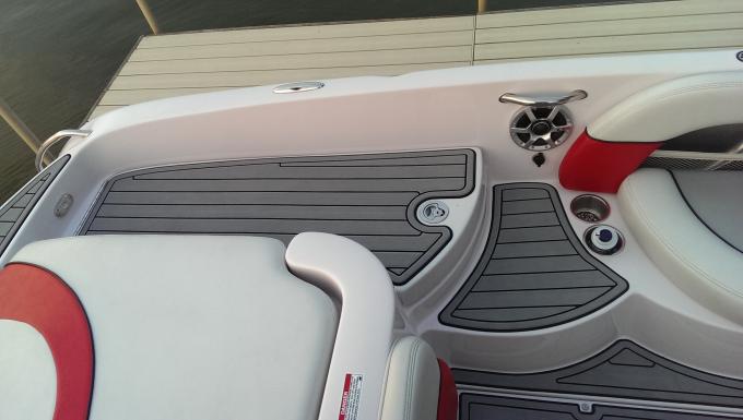

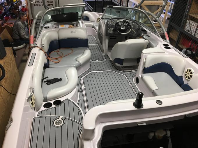

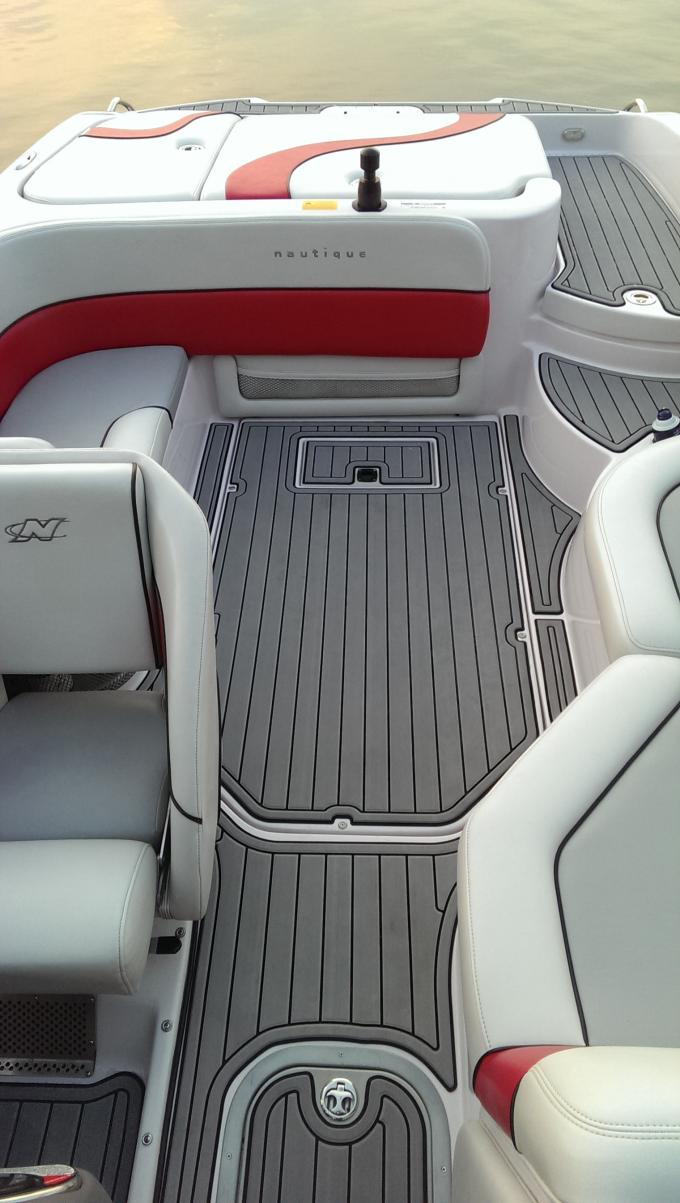

Just finished the install of Seadek in my 06 SV211. Started with the dry fit template of the drawing in the previous post. Had to make some modifications to quite a few pieces to ensure all the screw holes were covered. Very happy with the final result. Definitely a highly recommended upgrade. Some photos attached.
