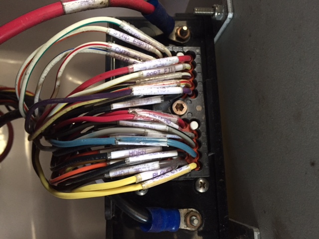

    I have read the past threads on this subject and hopefully someone can shed some light for me. To utilize the switch at the helm keypad the old posts say to access the PME 40 pin connector and use slot 11. All my 11's are used up. There are various open holes but I tested them all to see what got juice when the switch was turned on. No luck. Does anyone know which hole gets hot when that switch it activated?? Thanks

    Ok, sorry. I figured it out. The problem was I can't frickin see like I used to. When I posted the picture I blew it up on my phone and sure as heck there is #11 wide open. I didn't get my meter probe far enough in there when I check it the 1st time. Sure enough, it is the hot one when the switch get turned on.
