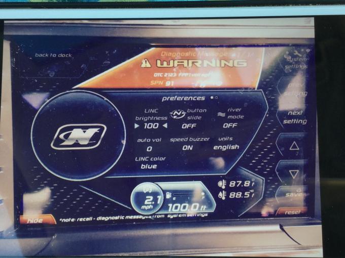

So my 2015 G25 with 9 hours is in limp mode with this error message. Has anyone had this problem and know if there is a "field" fix. I have identified that it is a throttle control sensory the code(according to my dealer). I have tried all of the resets that they know of, full power down and undo the batteries as well as a throttle reset. Nothing has worked. First weekend out, 15 minutes into our boat ride.

I had the same or similar issue with my 230 when it was new with less the 15 hours on it. We were on vacation 8 hours away from our dealer. Neither our dealer, PCM nor Nautique were aware of a field repair. Our issue was a throttle position Sensor and Nautique overnighted a new sensor to us at the vacation house. It corrected the issue and have not had a problem since.
Yes. The sensor that was causing my issue was easy to get to it was right on top of the engine, a few bolts and a plug. 10 minute job. Good luck. I know from experience how frustrating it is to have an issue with a new boat.
I had a issue like yours. My throttle cable became disconnected there is a quick disconect behind the throttle housing. Just plugged it back in and it was fine. Just something to check on
