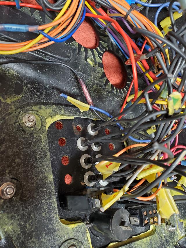

                I dropped off my dash shell at a friend's restoration shop because I don't have a clue how to repair plastic. I asked him about the retainer clips that hold the indicator lights, he said he'd look into it. He just shot me a photo of what he found, they might overlap a bit since the indicators are so close but I'm going to give it a shot. It'll be a few weeks before I get the dash together, but I will let ya'll know how these work. Click image for larger version

                  Emmett@Norman - just wondering if you got things finished up and how it turned out. Did the clips work? What did you use to splice all the wires back together?

                    OrlandoNautique,
                    The clips worked great, for a second I was afraid they would overlap but they fit perfectly. Here's a photo of the back of the panel.

                      Emmett@Norman - thanks for the picture and info. Did you end up having to cut all the wires? I can't really tell from the picture. Thanks!

                        OrlandoNautique,
                        Yes I had to cut all the wires. There's no way to get the indicator lights out without cutting them. I was careful to not cut any more than necessary and there was plenty of wire left over. The ground side of the indicator lights group together in groups of 3-4 and combine further as they connect back to the 'chassis ground' on the wiring harness. As things get shorter you have opportunity with the main ground to extend wires closer to the switch panel.
                        In the end, the previous 3 folks that modified my wiring had done some really bazar things to make it work. The stereo power wiring was connected through the heater switch for example. With all that cleaning up to do, cutting some wires was the least of my worries.
