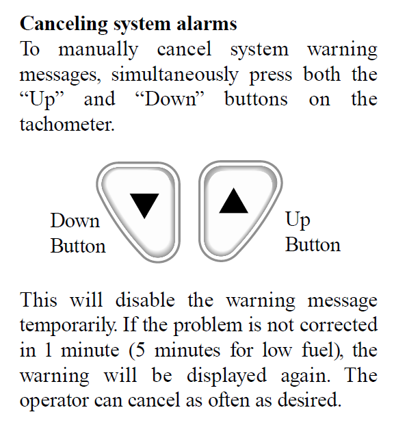

      well, the "M" button is just the mode button and below is all i found in the manual. basically just says you can manually cancel the alarm but that it would present itself again if the condition persists ...

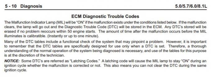

                      and here is an interesting detail about stored DTC codes and how long they are stored by the ecm before they will clear on their on (50 engine starts, really?!?!?! lol)

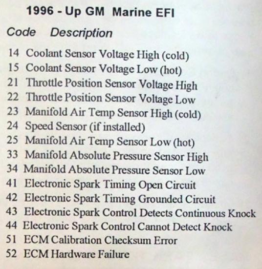

                        here is some clarification on the mefi-4 codes. dtc 43 when knock is actually detected, dtc 44 when the the ecm cant talk to the knock sensor. i should receive the codemate scanner this week and be able to determine which one i have, then clear it ...
