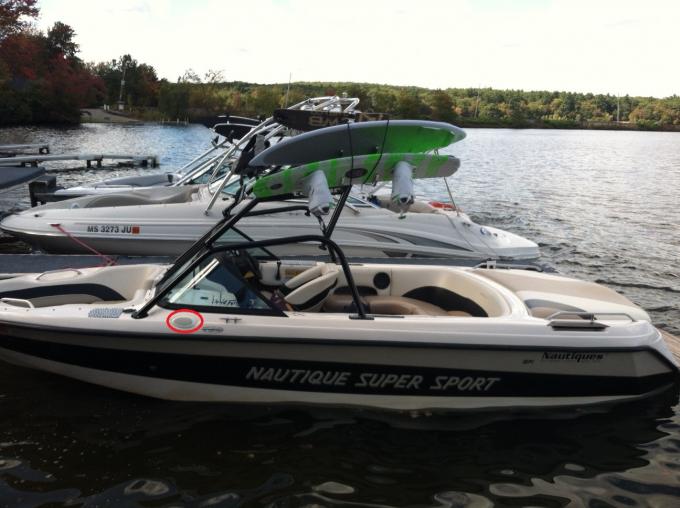

This might be the case in the 02-06 210s or other models but in the 96-01 SS/SAN the horn is easily accessed via the lift up passenger seat. It is right on the back side of the plastic vent circled in the pic. Open the passenger seat, get on your back and look up. As others have said it does sound like a weak ground problem. These boats are known for barely adequate wiring to the dash. Lots of people end up running better ground and power wires to a distribution block by the dash to resolve this issue. There are definitely some threads on here about it if you search.Originally posted by jhersey29 View Postthe horn is buried in the vent and getting to that requires taking a window off.
